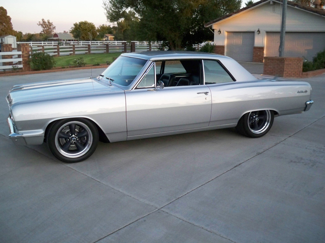

Any pics of lowered 64-65s. Im trying to figure out how much to lower it.
I was thinking of lowering my 64 3in in the front and 1in in the back. Has any one else did this? Any pics? What rims and tire sizes did you run?
Show me pics with list of how much it was lowered and rim and tire sizes please. Thank you

Here's one of my favorites, the Detroit Speed test car. 2" drop spindles up front along with the rest of their speed kit 3 which is tubular control arms, their Coil-overs, splined sway bar, and their rear suspension.

Dan - what wheels are these?
What wheels and what widths??

The Wheels on the DSE test car are Budnik Velocity R, which come in that color, or can be in all polished aluminum. The wheels are 18x8 with 4 7/8"bs in the front, the rears are 18x9 with 5.5" backspacing.
